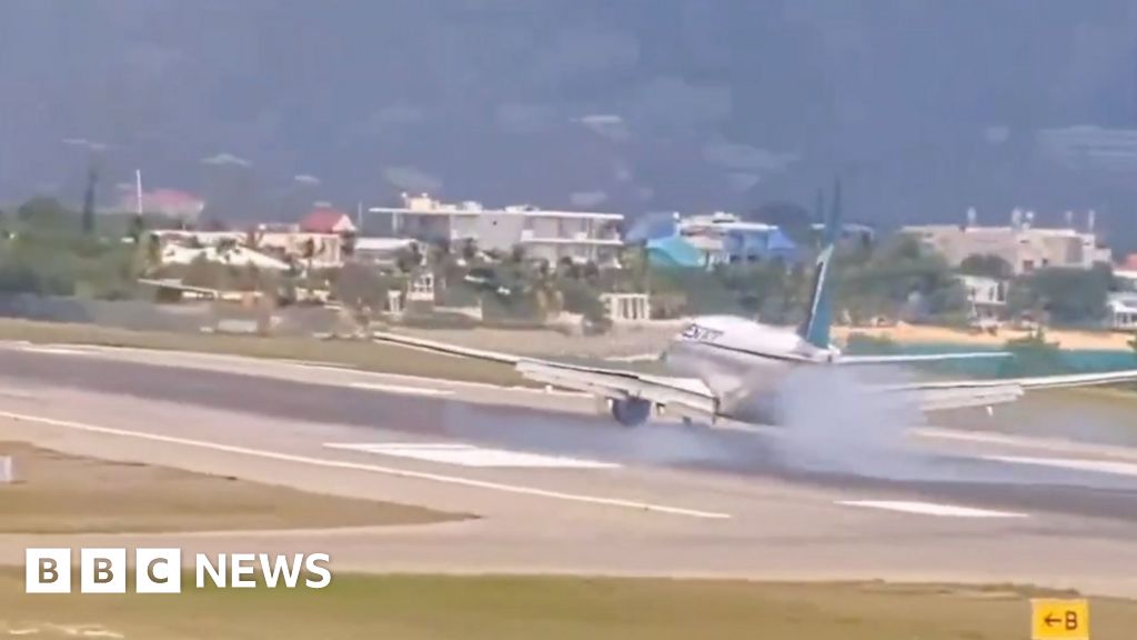

WestJet flight from Toronto makes hard landing in the Caribbean
The airline confirmed that all 164 passengers and crew aboard flight 2276 were safely evacuated.www.bbc.com
