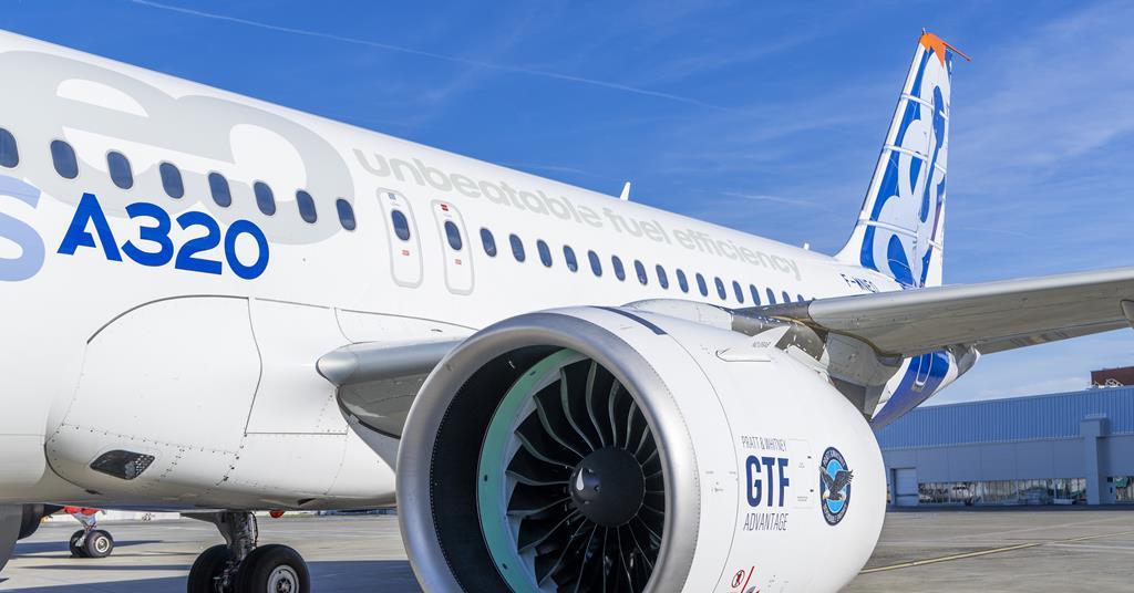

At the heart of the geared turbofan (GTF) initiative is the GTF Advantage (GTFA), a comprehensive core improvement package that targets greater performance while addressing nagging durability issues, particularly on the initial PW1100G variant powering the Airbus A320neo. Springing off this upgrade, Pratt has also developed a high-pressure, hot-section retrofit package, dubbed the HS+, to give existing PW1100G operators approximately 95% of the durability benefits of the Advantage.
Pratt received FAA type certification for the Advantage in February, earlier than expected. The company is “in the next steps” with the European Union Aviation Safety Agency (EASA), says Rick Deurloo, Pratt’s president of commercial engines, “and then we’ll follow that up with EASA CS-25 aircraft level certification,” he notes.
“All that right now is on schedule,” Deurloo says. “We anticipate both will happen in the next coming months, and we remain on track to ship our first production engines to Airbus by the end of this year, and then they’re going to go into service starting the first half of next year.”
Changes incorporated in the Advantage include increased airflow in the core to reduce operating temperatures and an improved hot section to double time on wing. “The technology that we’re bringing into this really is around enhancements throughout the gas path,” Deurloo says. “It’s fundamentally more durable.”
Enhancements to the high-pressure turbine (HPT) include an advanced airfoil design with more durable coatings. The HPT and combustor also feature optimized cooling hole size, shape and location to reduce oxidation, all made using improved water jet drilling techniques in place of the original laser drilling process. The overall combination is designed to produce a 4% thrust improvement at sea level and up to 8% at higher elevations while reducing fuel burn by a further 1% compared with the current engine.
